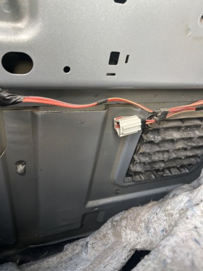

So…I figured out why the remote unlock and the TPM doesn’t work…isn’t this where it’s supposed to be located?image.jpg

Hmmm. That is where it is in my '16, but your 2010 may be entirely different. Don't see any mounting holes for the module there
I pulled the entire back seat out and that’s the only wiring back there. That was on the passenger side behind the back seat.

Hmm. The '16 is between the two vents, basically in the middle
I’ll take another look on my lunch. Now that you mention it, I just looked behind the drivers side and the passenger side…not in the middle. I’ve got all my tools in the truck so I’ll tear it apart.
