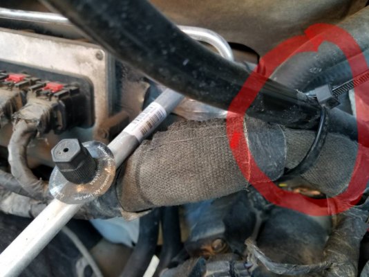

I have a 2012 with the same issue. The dealer replace the TIPM, but that didnt do anything to help. The only way I could get it to start after stalling was to either wiggle or unplug and reset the connections on the PCM. While poking around under the hood last weekend, I pushed down on the wire loom feeding the the PCM and I could get it to stall. Other times, by doing the same thing, it would run like **** until i lifted slightly on the loom. For the time, i have tie wrapped the loom to the transmission dipstick tube. At this point it is just a test, but since I have done that, it hasn't stalled. 26a64c05e2de8762be90d0619bcaed43.jpg

The dealer found a blown 10amp mini fuse in the TIPM. traced that to a chafed wire bundle that had chafed through the wire loom on the oil dipstick tube. A wire had chafed through the insulation and shorted out causing the fuse to blow. A quick easy fix and all is well again.
