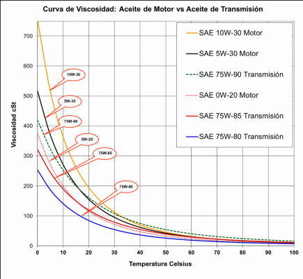

multi viscosity oil does not thin when it gets hot....it thickens.

I’m not sure what you mean by that, so you’re saying something like 5w20 gets thicker as it warms up?

I think it is more that it does not thicken up when cold, like a straight 30 weight oil would.
I do know that at -30 you can not get a 30 weight oil out of the bottle. I have been running syth. 5-20 in these for years, never had a motor open since the 1960's I remember one time , the block heater breaker went out, and in the morning it was -45., truck started O.K., thou it was not happy. My little 50hp tractor would start when cold , if plugged in, but the hydraulics would not work below -10 unless run for a while.

All oils thin when they get hot. Multi viscosity oils thin less than straight viscosity oils.

I’m lost lol. So was the other guy completely wrong then or is there something I’m missing here?
