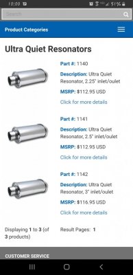

Thx for the tip Rick. Something I see they have I'm considering is their Twister resonator. 5" inch bottle like the Walker, about same length 18" but uses that auger tech which seems to get good reviews. I figure I won't be out anymore $ trying it and I expect I won't be any worse off sound wise.

Thats great to hear! I'm thrilled that you came up with the heat tape idea. I too have quite bad hearing in my left ear. Lol. I find thats whats left if I don't think about it I don't notice.
I still have a nagging thought to try the flo pro auger type resonator as I won't be out anymore money than my current Walker bottle...but if I end up taking a step back from a really decent solution, then I'm back to where I was 2 weeks ago & out 300 more canadian. My big road trip is in 4 days. After that its nothing but short sprints & because I'm not working/don't know if I will be working it seems frivolous because my next step would be trying a solo mach 44 (300 plus probably and 100 bucks install).
I did notice something else interesting today as well. Actually noticed it a bunch now that i'm really solution focused. So say I'm at 1500-1600 rpm but on cruise control & engine is under load (flat road) and I'm hearing a little drone... Then when I hit a slight downhill stretch so the engine load is reduced but rpm is showing as still 1500-1600, there is zero drone. Which made me wonder if what I'm hearing is drone persay. But then I think engine noise not handled properly IS causing the drone. And is not the same as exhaust noise. Plus for me anyway the annoying frequency of drone is low frequency. If that can be reduced it helps my tolerance...a lot.
