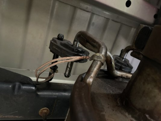

Hello,
Quick question. I was putting the factory exhaust back on for a long road trip and I noticed that the exhaust ground strap had rusted through. I plan on replacing, but is it okay to drive without it for a week or two?
Thanks in advance.

Yup. Above the muffler clipped to the bracket of the muffler and then to the bracket on the frame.

There is one on rear of stock muffler, does it really do anything?!?!
I wish I knew. I have read other forums where they say it dispels static that can disrupt sensors (TPMS) and mess with the radio reception. Who really knows?
Id drive without it and replace when i had time, make a better one.
yeah, I figure I’ll use the clips that were attached to the copper ribbon that rusted and use some copper wire to replace the ribbon.
Thanks for the suggestion.

Running with missing or damaged grounds can cause all sorts of issues . With today’s electronics I would not want to risk damaging any of it .

The little braided ground strap was starting to get green and crusty on my 2019 classic when I removed it along with the factory muffler to put my mufflex muffler delete pipe on. One end just clips to a muffler hanger, the other end clips to a hanger on the truck chassis. (single exhaust outlet 2019 SLT CC).
Zero issues in ~3-4K miles of use this way.
I will probably take my trip and see if there is any weirdness during it. After the trip I may just rig up some copper wire where the old braid was.

I actually just fixed it up. I fabricobbled the new one by cutting the old clasps from the braids. I then used a dremel with a cutting wheel to cut the solder and bend the clamps put. I heated it to remove the solder and remain copper braids. I then stripped two 7 inch lengths of copper speaker wire. I placed the ends of those wires in the clamps and clamped them down. Good enough for government work.

More than likely a "rf bond strap"
Dispells static but mostly to make rf travel equally through the un mated part of the truck..
Same idea helps static for high end audio and cb tx/rec..

A lot of manufacturers provide some sort of exhaust system grounding, the primary reason is to ensure proper O2 sensor current return. I've seen radio static produced from defective ground straps on the exhaust. I'm guessing there are other reasons as well. On third generation Rams there was a TSB issued to address broken or missing ground straps on the transmission to address erratic shifting issues.
