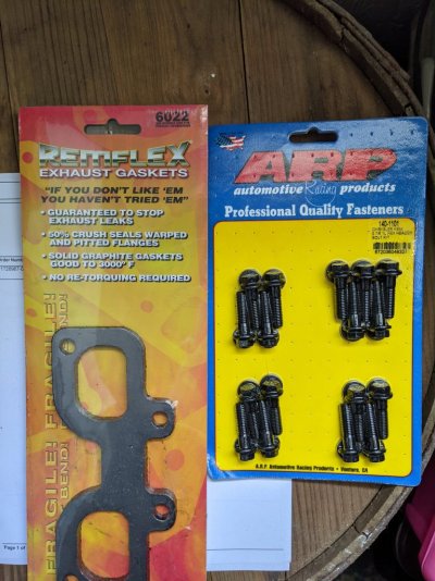

Using the Warranty (If still applicable) will get you OEM replacement Bolts. Possibly new manifolds, however, neither of these will be a permanent fix. You will end up in the same spot at some point.
Option 1: Cheapest. Resurface your current manifolds, Buy new gaskets and bolts and install.
Option 2: Buy New aftermarket Headers, Gaskets and bolts (LT or shorts, each come with their own setbacks and/or positives, ie. tunes, fitment, etc)
For Gaskets the best IMO is Remflex. They are thicker, dont require retightening, and arent brittle like the OEM ones.
Model # 6022 Fits the 5.7l Hemi
For Bolts The Best are ARP,
Model #140-1101 fits the 5.7l Hemi
If you end up doing the work yourself, here is a quick write up on removing snapped bolts with a welder:
Appreciate it, I work at a dealership so I planned on buying the parts and having service install them. Just was looking at shorty bbks for headers.
