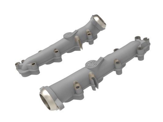

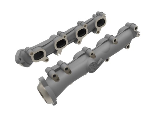

In case anyone is interested AFE has come to the manifold game
Details​
  • Outflows the factory exhaust manifolds by 15%, improving performance and throttle response
  • Thicker walls for increased rigidity and crack resistance
  • The machined ports match the factory gasket openings which maximizes exhaust flow
  • Durable cast ductile iron construction
  • Manifold mounting hardware is included for a hassle-free installation.
Machined Ports: These manifolds have both the inlet, and the outlet ports machined to match the factory gaskets. This allows for maximum flow, without compromising gasket performance.
Hassle-Free Installation: These manifolds bolt directly to the factory y-pipe for an easy installation.
Increased Wall Thickness: These manifolds have 25% Thicker walls than the crack-prone factory manifolds. The increase in thickness increases the rigidity of the manifolds and make them much more durable than the OE manifolds.
Emissions Disclaimer
This product is not currently CARB exempt and is not available for purchase in California or for use in any vehicle registered with the California Department of Motor Vehicles.
MSRP is currently $523.95, if anyone is interested in a set just send me a message.

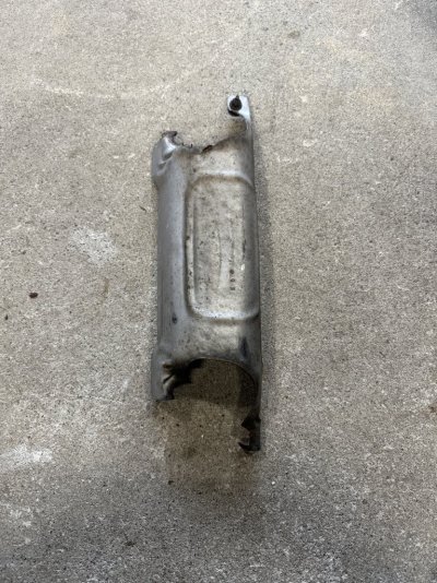

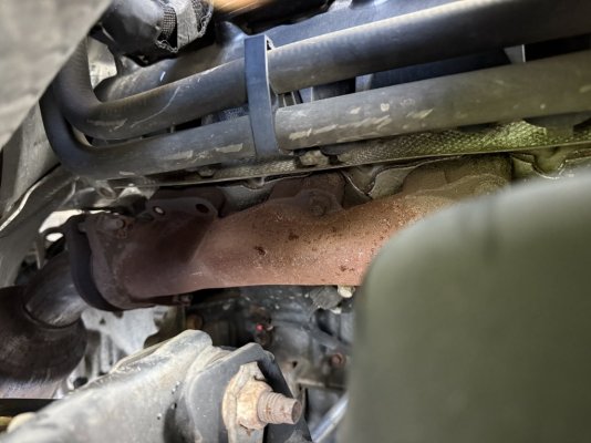

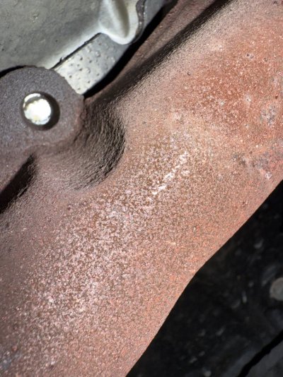

Just noticed my shield was off passenger manifold, yup 2 broken on that side from what i can see. Drivers side is still see them all in place and shield tight but who knows.
You guys replacing the heat shields also?
My 2016 has 47k miles.

For my broken bolts I welded a nut on the end of the broken bolts and they came out easily. Hoping good luck with yours as well.
I put the heat shields back on because they weren't overly rotten yet. I'm sure the next time I have to do this I'll leave them off. I do tow a lot and worry a little about temps under the hood, but I'd still run it.

I would need new ones, this one anyway rotted off and nothing to attach to at 3 locations.

I can't remember if it was said in this chat either, but there are a couple varients of stock manifolds. Earlier gens had an issue where they would break bolts and warp, the newer ones actually crack and need to be replaced. I have a 2019 Classic, and they cracked... my brothers were the same on his 2019 too. None of our bolts were broken.
I forget the year cutoff where that changed... there is also a "new" manifold that is supposed to fix the cracking issue now, he installed those and I installed the older style so we'll see how things hold up. :)
