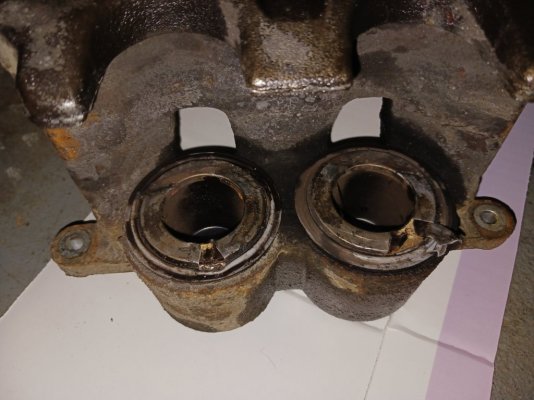

Drove my 2021 Ram Classic 54k. Was stopping fine. Put Powerstop z36 pads and 4 rotors. Npw the front wheels hardly spin. I took them off and found a messed up caliper. Checked everything put back together still drag. Not enough to turn the rotors red but still clearly dragging. I wondered if i messed up the ABS by using my tool to force pistons back in and i had forgot to take my mc cover off. I was super careful with hoses. Back is fine. Both fronts equal drag. Still totally confused how chunks got taken out of caliper piston. Slides are greased. thanks for any help.20231206_193218.jpg

I doubt you messed up abs, when you say your tool you mean caliper pressing tool or something else? I'd rebuild the caliper piston if it were me. Are the pins good? Those two things I would do first assuming you checked obvious stuff such as brake lines and fluid.

those calipers are garbage now.. you did not force the piston back far enough to clear the little metal **** on the back of the brake pads and you forced the pads out ripping chunks out of your pistons, this is what is causing your drag now.. Made the same mistake the first time i changed the pads on my truck.. To me its not worth rebuilding calipers i just buy new and be done with it..

Looks like you need 2 rebuild calipers, those pistons are trashed, I would replace the brake hoses also.

oh no !! why the brake hoses too? I dont understand what you mean by not pressing the calipers back in far enough. What hit the piston and how did it wreck the hoses. Thank you for your help.

I totally believe I did something wrong installing but I honestly dont understand what you mean. Mew caliper still drags a little. Im stumped.

Well if you didn’t go far enough in and the metal backing of the pad catches the lip of the piston the piston could chip and crack. I have not done that myself but I could see it happening but I think you would notice some debris falling as you assemble it back together unless it held togther till it heated up and then when you took it off it crumbled is a possibility… but I have had that one time a caliper just seize up and that was from advance auto
