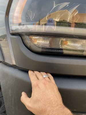

Is there a gap above the bumper? I never measured from the ground to the bumper. Do you have a picture handy?

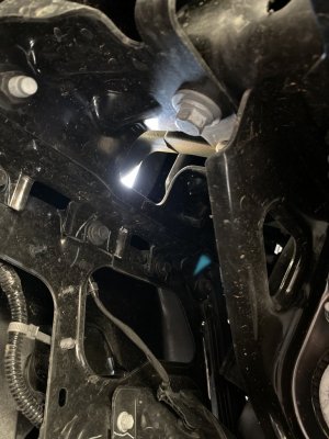

I'll get a pic tonight. The gap is between the top of the bumper and the bottom of the trim (or whatever you call it). Visually you can tell the slight difference, and measuring confirms it. After doing some more research, it looks like the problem may be the grill/facia and not the bumper. Also from what I can tell, the bumper can't be moved unless you remove the sheer pin and elongate the mounting holes.

From what I've read that's not the way it works on the 5th Gen trucks as a retention pin keeps it from moving. Do you know differently? Everything I've read is that you have to remove the pin then elongate the bolt holes if you want to move the bumper.
No, I dont know any differently. I just assumed it was like any other bumper I have seen.
I personally would crawl under it and attempt it before I went and bothered with the dealer. If it is like you say, it may be worth the hassle with the dealer, but if its like most other bumpers I would just do it myself.

I also just checked and it's definitely the bumper and not the grill (like others have reported on other forums) because the gap is still not equal when you measure out where the bumper meets the bottom of the fender.
It's one of those things where I'm the only one that's going to notice it, so if there are sheer pins that keep it from moving, I'll probably just live with it instead of potentially creating other problems by trying to remove them and elongating the bolt holes.
