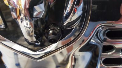

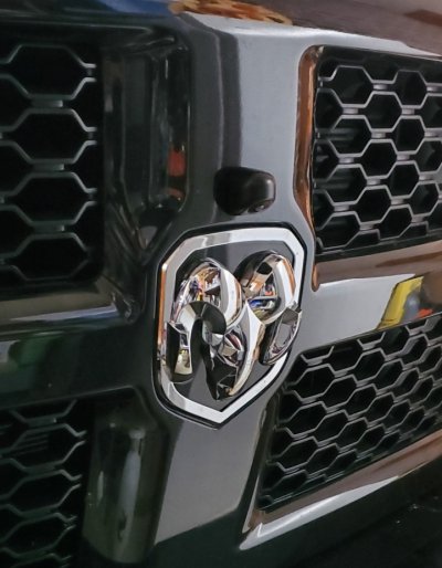

Hardest part was pulling the trigger on the drill. Now have to wait for fuse taps from Amazon to power the camera, couldn't find any locally. 53f20ccc6726698aafb2fd95495ed9b2.jpg857a05ff005cd91a7d60859be67c61e8.jpg

I had the same concerns about the drill. I installed mine so that I could replace just the emblem should it ever become necessary for any reason.front cam.jpg

I had the same concerns about the drill. I installed mine so that I could replace just the emblem should it ever become necessary for any reason.View attachment 235160
I would like to have done it that way but my camera was too big to fit there

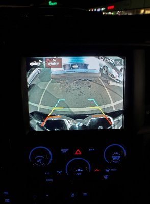

is you r display backwards? Mine is and I'm wondering if anyone has found a setting to reverse it

I like that your camera gives a wider view. The one I have, supplied from Customtronix, has a narrower field of view. But it's also integrated into the badge which camouflages the camera which I like, since my paint is blue. Yours blends in well black on black!
I looked at Customronix but I couldn't stomach the price. I'm all about cheap. I think if I had a different color truck I might have considered it. Or maybe just shoot the camera with some rattle can touch up paint. I took it out last night to try it out and it really makes parking a lot easier.
Mine was backwards and upside down. The camera has three colored wire loops in the harness you can cut. One flips the image right side up. One changes from mirrored image to normal and one removes the parking grid lines.

which one did you cut? looks like the purple one from the information given

It's camera specific. Not all are capable of image flipping.

I had to cut 2 but I don't remember the colors. I didn't cut the one for the grid lines. Looking at the instructions on Amazon purple would fix upside-down, white for backwards image.
Sent from my SM-G970U using Tapatalk
Yeah it did have a hefty price tag, but I now also have functional front, cargo, and backup cameras. I have to use all three Everytime I'm in the truck to help justify the cost haha!
