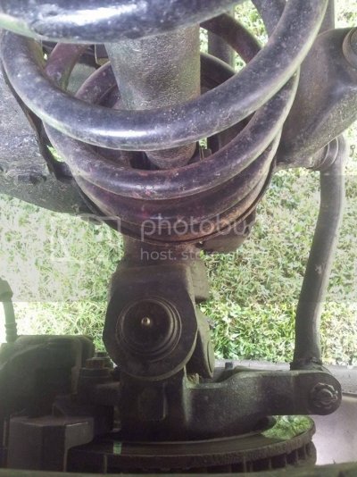

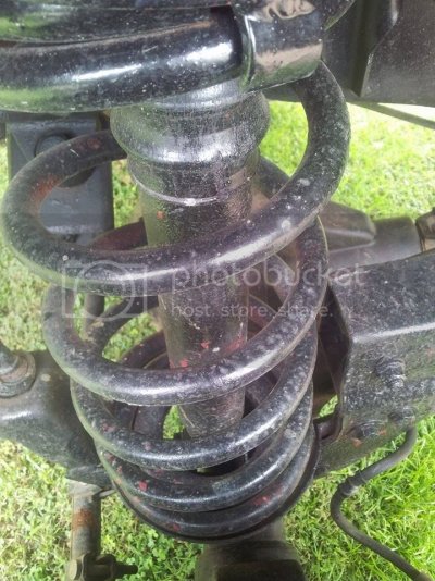

Looks like it has a Skyjacker lift on it that someone cleaned up and spraybombed black. lol

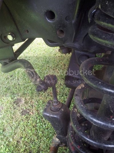

And those sway bar end links.......I'd suggest a Dana 60 and 98.5 T-steering.

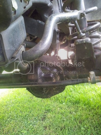

Yeah the previous owners spraypainted all the skyjacker items black. lol and I have no idea what kind of front end is in it, people have t old me dana 60, no idea lol. I am just looking at rebuilding the steering parts so my new tires won't be eaten up and won't have so much play in the steering wheel.

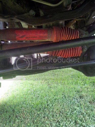

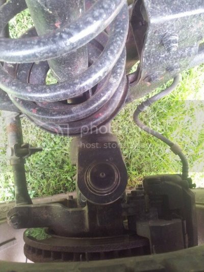

It is a Sj 5" kit with spring spacers and extra rear blocks added to the 5" kit. It looks like a Dana 44 get the BOM numbers off it and post them up, does it have 8 bolt rims or 5 bolt? DD94 was or has suggested that the Napa Gold parts are better then Moog you might ask him. I see too short of brake lines, brake lines hanging under the motor cross member, there is lots of work to be done to get it up to snuff. The Sj 5" track bar braket is not going to cut it with 10" of lift you need to find a better set up for that.

Op have a look at this for a steering set up. You are going to need something along those line to go with your lift.
DTP02031-02 94-97 HD STEERING LINKAGE
