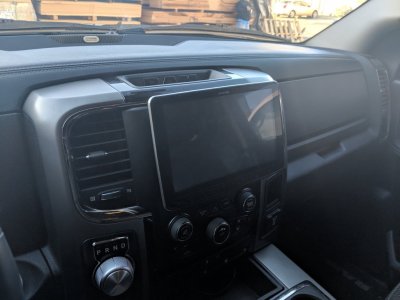

I installed the Alpine Halo on friday and everything went smoothly with no issues, including programming the idatalink module.
Pros:
1. Retained all factory functions, backup cam, steering wheel functions, HVAC controls through the screen, all factory settings are also accessible with the Halo just like the Uconnect 8.4.
2. Volume knob, fan know, tuner knob, and all hard keys work and interact with the screen.
3. The unit is extremely sturdy and has no give even when tugging on it with force. I dont off road but if I did I would not be concern.
4. The unit is fast and very responsive, Android Auto is nice on the 9" screen.
Cons:
1. The unit does protrude a bit I have about 3/8" more that I can move it back and still have access to the top mount screws that the screen requires to mount. I dont feel this is a deal breaker as I feel I am already getting use to it.
2. As for the screen its not bad but its not mind blowing I think we have just become spoiled with cell phones having high end screens. The screen is fine I don't know why you would need the screen to be HD.
3. I notice the back up cam has maybe a 2 second delay after I shift the truck into reverse.
4. Wireless Android Auto (Non Existent) - I don't mind since I routed the USB cable in the storage pocket in the center console closest to the radio.
5. Only one USB port.
Overall I am very happy with the unit and consider it an upgrade over the factory 8.4 unit. I will be keeping the unit and upgrading my sound system overtime.

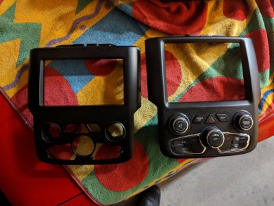

View attachment 155164 View attachment 155165 View attachment 155166 View attachment 155167 View attachment 155168
Thanks man looks much be than the previous install I had seen. They went too high with it. Being that you had the 8.4 prior how do you feel the difference in screen resolution quality is between the two?
I messed with it some more today and was able to set it back about 1/2" more. As for resolution it's better than the stock 8.4 but it's not leaps and bounds better. But a lot more responsive for sure. I hated having to use the temperature slider on the HVAC screen it was never smooth and always frustrating the Halo is smooth and the bigger screen is so much more pleasant.

1. Alpine iLX-F309 HALO9 9"
2. Maestro HRN-RR-CH3
3. Scosche CR1297DDB
4. Metra 40-EU55 Antenna Adapter
5. Maestro ADS-MRR
6. MicroBypass Parking Brake Overide for Alpine .
