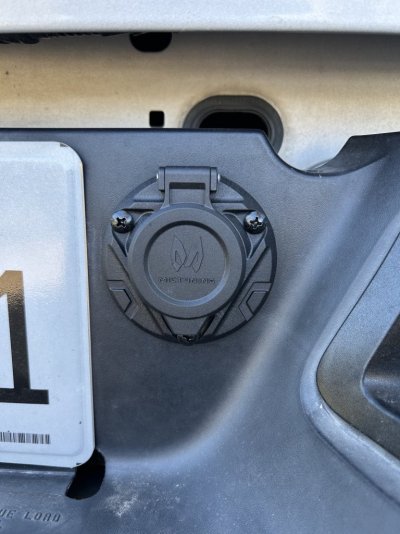

You all convinced me to upgrade to the H8 as this truck seems to drain batteries more than any other vehicle I have owned. Added the Nocco 2D on board charger but have not hooked up the power yet. Would like opinions on the hookup below. Look proper and safe? Hot lead to positive post, negative to chassis ground. Plug to back end with 25' heavy duty extension cord, heat shrink connections and weather proof port. Charger secured with 3M Velcro Dual Lock.

That's too funny, I mounted a NOCO in almost the same location! I didn't do the plug, it's garaged so just pop the hood.
