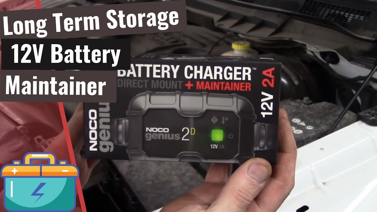

Is there an adapter than, that you could hook into the plug for the NOCO to go like to the front of the grill with a cover on it? The last thing I wanna do is leave my hood open for any reason.
You could buy a cheap block heater cord with a cover,cut the block heater end off,run it through the grill,and either add a simple female plug to it,or solder the end of the chargers cord directly to the cut off end.Depending on the actual end of the charger,you might even get away with just adding a cheap cover to the cord end.

South Main Auto installs NOCO & tells his initial thoughts on installation, etc.
When NOCO charger was made in China
Englishman disassembles it to see if is a good charger ??
Solder? What century is this, my man? Shrink tube butt splice!
The idea to mount a static battery maintainer inside an engine bay never occurred to me - don't know how long it would last exposed to constant high heat plus vibratory shaking. I always assumed they were for wall mount only. So that's what I did, and extended the 12V wired out of the engine bay instead of the 120V input lead.
I guess having it installed on the vehicle means you can plug an AC extension to it for charging if you're on the road a lot, but I'm not so didn't think of it.
Anyway, NOCO "was" made in China? I thought it was always made in USA?
AFAIK, NOCO started out being made in the USA but shifted to PRC like everything else.
The NOCO 2D I bought last year is made in China. I'm not so sure about how long it will last living inside the engine bay but the idea of customizing the rate of charge to the battery's environment sounds sensible.
Likely a very bad idea for those in excessively hot environments but, batteries never last there anyway. :cool:
