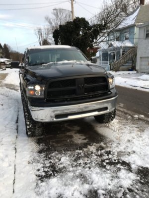

I installed these LED bulbs in my halogen projector headlight assemblies. Cost me $25 with anti flicker harnesses. I didn't feel like spending $250 for the same chinese cree bulbs found in the morimoto kit. I am very happy with the results. 5x brighter than the H1 halogen bulbs. Anyone that says LED bulbs will not be proficient in halogen projectors is sadly mistaken. Save yourself a ton of money and purchase CREE LED bulbs and supporting harness instead of high priced Morimoto.

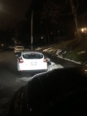

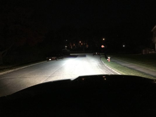

I think you may want to adjust this light pattern. I believe it is too high, you will be blinding people in their rear view mirrors (the cutoff may be lower than on coming traffic drivers eyes). This is my cutoff, with HID's my cutoff is right at the top of the average car's bumper (even as close as you are in the above picture):

Thanks i never adjust them, just put them in. I'll adjust them down.

EDIT to my last post. I adjust my HID cutoff to the top of the car ahead's TRUNK... Not bumper like I said in my last post, that would be way too low for highway driving.
