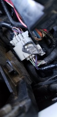

my body connector had these wires in position 1 and 2 on the body side of the BCM connector, but nothing on the output side. I have pinned the matching wires from a harness I built to the opposite side? Does it make sense that on my 2013 these wires are in a different spot than what's pictured previously in this thread?

Here's my connector and the added harness for the hood switch.
