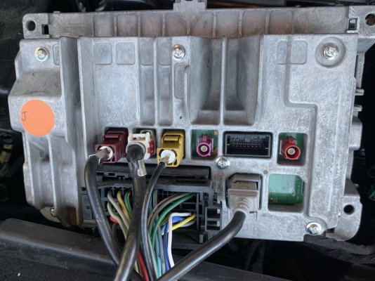

I pulled the fuse for an hour and put it back in. Still not getting the SXM icon (I do see the Sirius logo on the startup splash screen). But it's not resetting. Should I do the screen menu reset all settings?
I also don't see any options in the menus for Safety and Driving Assistance, Miiror and Wipers, Lights, Doors and Locks.
The System Information menu only shows an option for Software License, but no version info.
The Locked Radio message did go away in the EVIC, but still no backup camera. When I put it in reverse, the EVIC just says Vehicle not in Park.
I think I matched up the wires right but here are the connections.
Don't bother with the fuse or battery connections. Lock the truck and come back later. Hour or more. Or over night.

Your radio hasn't refreshed yet. How long are you allowing it to sleep so it can refresh itself?

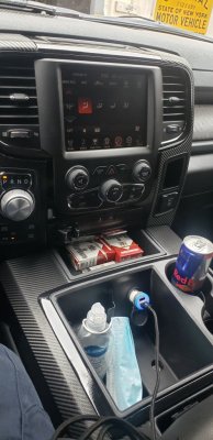

Before:
After:
Final:
