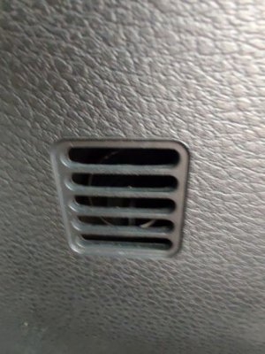

I did the MTC to ATC mod over a year ago and it went pretty smooth. MPGrimm2 provide the harness, temp sensor, and made necessary mod/integration of the OE MTC HVAC controller to a single zone ATC. Pics attached show bezel and single zone ATC on-screen controls, temp sensor in the knee bolster, and the location of the 20 AMP radio fuse. Installation requires a harness to interconnect the HVAC module, located under right side dash and accessible by removing right side kick panel, the temp sensor located in the knee bolster, and finally connecting to the back of the HVAC control module on bezel. I had an issue when adjusting temp by holding down the switch, the temps would appear in counters on both sides of screen like a dual zone system. Further discussion with MPGrimm2 resulted in returning all back to OE config and then run the procedure again, this time removing the fuse between config changes with Alpha OBD. In the end it did not work. So if the temp switches are pressed and held until desired temp is reached, it shows on both sides in radio display. If switches are pressed and released to increase/decrease temp a single number at a time, then only the left side counter shows in display.
Changing to ATC is a matter of convenience. Set the temp and system maintains set temp by adjusting the heating, cooling, fan speed, blend door, and vents as needed to maintain set temp. You can always override, return to ATC, or run manual. With MTC only, what ever is set is what runs continuously until you change a setting in temp or fan speed.
Radio Display with Sigle Zone ATC.gif Knee Bolster with ATC temp sensor.jpg Radio Fuse '16 RAM 2500.png
