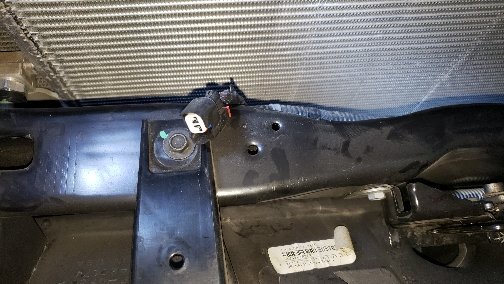

If you don't care about the hood...I may have missed this somewhere...but what connectors are used for the pcm plug on the motor side? I had the harness from the latch, and installed the new latch. Pin 11 is empty and I have the BCM connector(s) ready to order just haven’t seen a link or part number for the pcm side. I have a ground lug just need to fill 5 & 6.
thanks for any help.

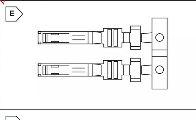

I was unable to get a good picture from those links.I somewhat care about the hood since I bought the latch. I was thinking of bypassing the plug under the fuse box all together and basically making a mock harness they sell with the kit by just tying into the factory hood wiring/plug. 40 bucks seems a bit steep for the kit just to try and wire it as if it came from the factory but I like the idea of it. I found some terminals but not sure if they’d work or not.
https://www.mouser.com/catalog/catalogusd/646/1613.pdf
https://www.mouser.com/ProductDetail/Aptiv-formerly-Delphi/211CL2S2160/?qs=HumNWfwekiGBekSP4y87ng==

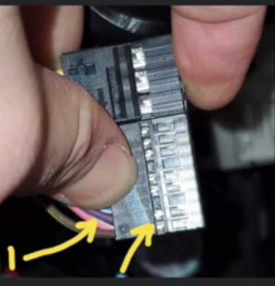

This is what the pin looks like. I don't know if it comes in different sizes, but that's what it looks like. (Pic)I somewhat care about the hood since I bought the latch. I was thinking of bypassing the plug under the fuse box all together and basically making a mock harness they sell with the kit by just tying into the factory hood wiring/plug. 40 bucks seems a bit steep for the kit just to try and wire it as if it came from the factory but I like the idea of it. I found some terminals but not sure if they’d work or not.

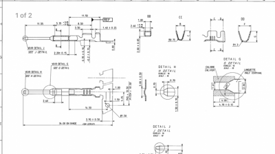

Honestly I don't know about all that stuff lol..the cutsheet from the 2nd link is attached. Is your pin from the hood plug or from under the fuse box? From the terminal repair kit it matches the wording, but no clue if it’s an actual fit. That’s my reasoning for thinking of doing what y’all did with the 2019 you mention.
