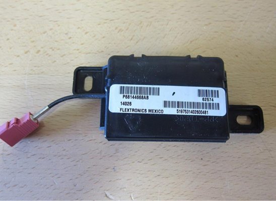

I did not. There is no connection for it on the factory hub, which is why the full kit includes a new one. Range is going to be exactly the same as it is now for your keyless entry(less than it would be with the external antenna );same key, same antenna. I’d be interested to see if that board has a spot where you could solder on the Fakra connector. If I had to guess, I’d bet it does.
I’m installing the Keyless Go, and will be adding the external antenna. This was really just a free test of my hood latch wiring and setup. But, I’m trying an antenna from a Grabd Cherokee. I’m pretty well convinced it is exactly the same just with a longer antenna pigtail. It’s $40 new vs $100, and I got one on eBay to test for $20.

Have you had a chance to try the Jeep one yet? I checked the part numbers and the Jeep one is listed as a "Keyless Entry Antenna", the RAM one as a "Remote Start And Keyless Entry Antenna".

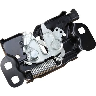

Has anyone tried getting one of these $25 eBay hood latches and moving the switch to their OEM latch? It looks like it's held on with one screw and a couple of plastic locating pins. The holes are already there on the non-switch OEM one.

Interesting idea. I've got my new latch laying on the bench at home, and was planning to install this weekend. Let me take a look at this.
