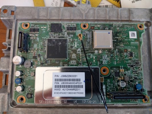

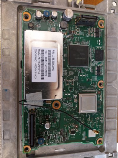

The other one may have been a failing unit or a franken-radio. There are some sellers out there that take parts from different failed radios and try to put them together into a working radio. It seems parts from different PN (last 2 letters) radios may have incompatible revisions.
I can tell you after close examination of the internals the parts between UAS and UAQ are possibly entirety interchangeable as well but I don't know what that may mean when flashing firmware.
To be honest, it was hard to tell the difference (if any) between models. Almost as if they are the same radio but software locked at the factory.
Here are some PICs...
UAS
UAQ

The big silver unit (satellite radio module) has a different part number. The UAS looks newer than the UAQ based on the date code of the satellite radio module. The flashrunner (handles system upgrades, big square black chip) is the same part number. The PCB part number is different. I can't read the part numbers on some of the other larger chips. It would make sense they are the same basic design but the UAQ probably has some different, possibly beefed up CPU, hardware to handle navigation definitely different system software. It is all in the part numbers of the chips and if they exist in both radios. They make look the same physically but different part numbers have different capabilities. Also, some chips allow activation of different features by "wiring" up different pins. To see that in a multi-layer PCB requires X-rays and or CT scans.
Makes sense. I believe everything outside of this one board (pictured in last post) in each is entirely interchangeable for repair purposes. But as I said earlier and I believe you alluded to as well, I wouldn't want to flash firmware to one (unless it was already bricked)...
