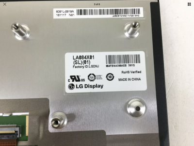

Screens for the UAQ and UAS radios can be bought directly from China for as low as $73. I know China anything is a sore spot right now but vendors on Alibaba com have the LG screens. Using PP to pay, you have some protection. LG part #
LA084X01 (SL) (01)View attachment 200868
Posted about that a while back. I believe the $73 ones are salesman samples and not meant for resale but they should work just fine. I think with shipping it's just under $100.
