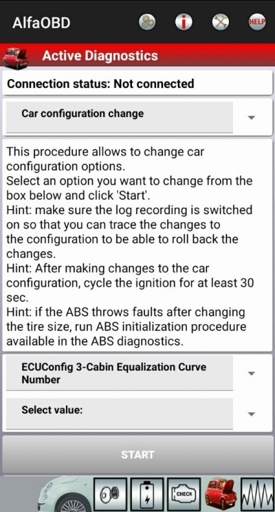

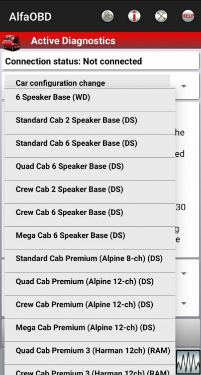

Anybody for the rear speakers not working issue?
Using AlfaOBD, you could try..
... go into BCM/ car configuration change/ECU Config 3/ and select Cabin EQ Curve Number ... Set it to another DS truck's 6 speaker system, reset shut the truck off, reset the radio (pull inline fuse/or battery) and wait for the radio to finish it's reset (when sxm button shows up and backup camera works again). Once done, and if it works, try putting it back to the correct setting for your truck/Cab config. e6e42f3a1ea31e648df432174a0782a7.jpg621df67a03ebcb5f7ac776e365f8514b.jpg

not sure what’s up with mine, when I get to the value change, there is no drop down menu for cabin curve, there is only a value field where it asks for a manual input
What year is your truck?
Maybe try a different year /truck group for your BCM... I pulled this up on the app without being connected to the truck. If it's not showing the options, b may need to contact the developer to get it fixed again

got alfaobd to show the right things now. Tried setting to different speaker configurations a few times, still nothing coming from rear speakers
