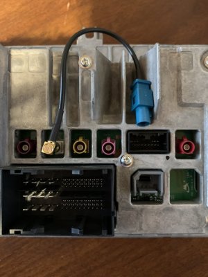

Can anyone tell me where to get one of these 6-pin to 8-pin adapters for the newer media hubs? or even just the plug and pinouts and I'll make one.

Those are the ones I'm looking at ... ETA is March :(
I do have both - do you want me to post here or DM? Truck was a 2018.
Is there any reason I cannot "break" the fakra on my original 8.4 and glue it onto the back of the new 8.4? Similarly (and likely not as stupid of an idea) could I get a replacement fakra (like this Fakra Plug male End Launch PCB mount Right angle connector white/9001 New | eBay), disassemble and glue the plastic / barrel onto the 8.4?
Go ahead and message me the VIN/year/radio model/ pn...
I want to check build sheet and other info to possibly update the thread at some point.
Also,
I don't think you will have any luck buying any pcb connectors to get the plastic piece off of.. I order a few different one and couldn't find a close enough match that would work.
The connectors used on the 13-17 Harmon radios are different than the 2018+ Panasonic radios and likely won't work well either.
The Pigtail is the best solution IMO, unless you have a scrap Panasonic radio board to rob parts off of. The fakra z will work.

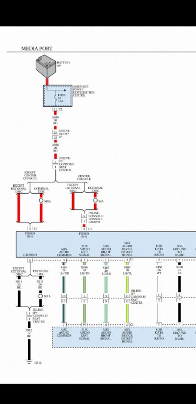

Ok ... I feel like I'm missing the obvious here. I've assumed that the fix for the "backlight on when truck off" situation with the 2018 hub is to cut pin 7 on the conversion harness from M2 mods.
I've been researching to confirm and it seems like you actually need to cut pin 7 on a different harness on the truck down where the console lid hinges - is that correct? I'm really not liking the idea of cutting up my truck harness if I can avoid it.
Am I misinterpreting what I'm reading?
Probably makes a difference to know what I'm running also; I have the factory 2015 center console, factory 2015 lid. I put the M2 mods adapter at the end of the factory 2015 media hub cable and plugged the 2018 media hub into the M2 adapter. Everything from behind the M2 adapter is 2015.
We don't build the hub adapter harness with the panel lighting wire (pin 2 on the new hub's 8 pin connector), since there isn't anywhere (nearby) to grab the signal... (Trailer brake sw is the closest point)
The pin 7 issue mentioned in post 5 (please follow the link and look at the pictures in post 40 of CircuitGuy's thread), is when mixing a 2018/classic console lid (with factory hub) into a 2013-17 truck and deals with the 8 pin console lid connector under/behind the rear panel of the console below the hinge.
>> For that situation only, 13-17 truck console wiring has +12v from battery at pin 7 of the lid connector to run the 12v outlet in the old lid (next to the 13-17 hub)....
>>> On 18/classic wiring, pin 7 of the console lid connector has the panel lighting signal for the hub (& no 12v outlet).
>>>> So, if you plug in a 2018/classic 8pin console lid connector into the 13-17 truck's console wiring, you end up with +12v going to the 2018 usb hub backlight ... Which will be on constantly and drain the battery.
** Side note, If I recall correctly (I don't have a 4th gen anymore to check), when power is first applied to the USB Hub, it will light up briefly before looking for the panel light control signal (even if one isn't present).
It's possible something is waking your truck up randomly or there is an intermittent issue with power to the USB hub.... A customer of mine recent had a faulty/blown fuse in the PDC for the usb Hub. Not sure what happened to pop it done it was working fine for 6mos.
PS: when you get the 2017 Chrysler 200 dual usb hub, let us know how it works with the UAS radio... I'd like to see someone else verify it (preferably with a verified Ram radio), before we push it as a best option.
