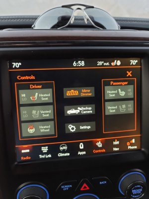

After numerous attempts to correct the issue with my heated seat controls being greyed out, I am at an end. I could not fix it and have run out of options that I can see. I have tried all the configuration changes and options in AlphaOBD, received a new UAQ head unit, and even went as far as purchasing the module from infotainment.com for the MY 2014 trucks. Nothing has worked. My last thought would be maybe a software bug with the head unit but I doubt I would be able to correct that anyway as I don't have the VIN for the truck it cam from. Anyone else got any suggestions?

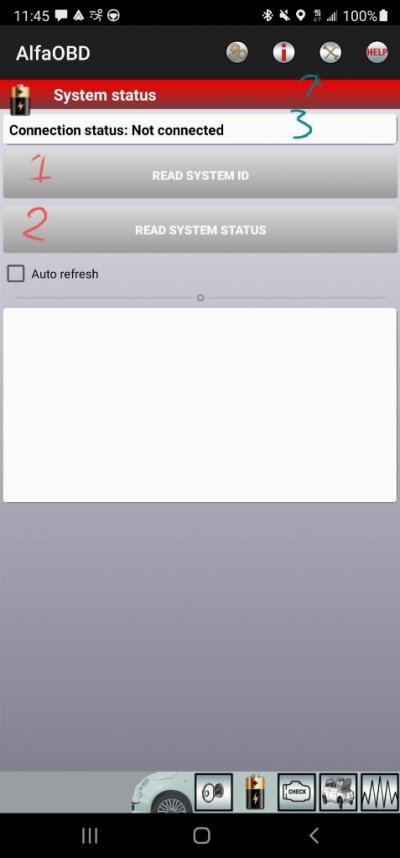

I have android version.
Attached is what I see. Buttons are there. Seats will even be on but I can't control them.

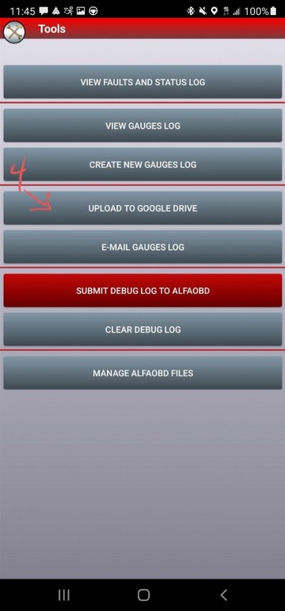

Connect to the BCM then go to the battery icon on the bottom. Hit the following buttons:
After that, hit the button with the wrenches on it and hit upload to google drive.
Repeat the steps for the HSM. It is under "Driver Seat" in the second drop down then select HSM MY2013-2017 PowerNet.
