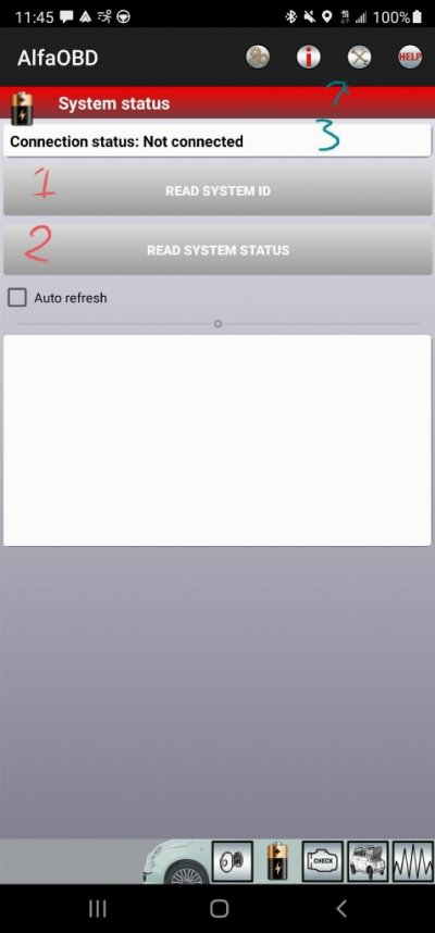

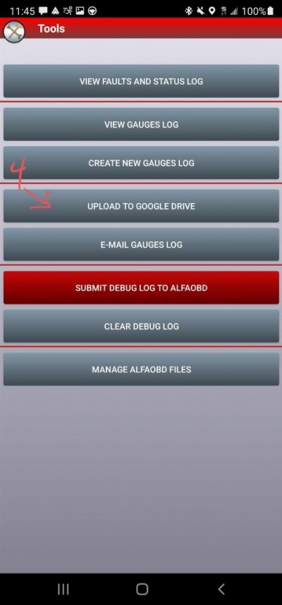

Connect to the BCM then go to the battery icon on the bottom. Hit the following buttons:
After that, hit the button with the wrenches on it and hit upload to google drive.
Repeat the steps for the HSM. It is under "Driver Seat" in the second drop down then select HSM MY2013-2017 PowerNet.
Attached are the logs. I looked at them and couldn't see anything odd, but then again I am not experienced with this.
  • Body_computer.zip

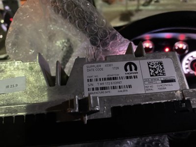

Finally able to pick a part from the wreckers, found a 2018 radio, VIN says it’s a 2018 Ram on the software update page, I have the media hub and connector coming, I’ll install the radio on Saturday, I hope it works. I am unsure if this is a navigation or not, appears to be a UCS. Anybody know of any issues with this particular radio?
I don't believe that has the built-in navigation, it would have the part # of: 68331631A* (the * changes per revision).
That appears to be a 2019/2020 ram classic Canadian UCS non-nav radio based on several sites I've found.
2019/2020 RAM classic Canadian 8.4 UCS non-nav
68340153ak.
