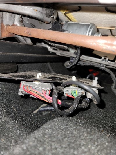

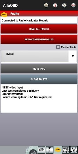

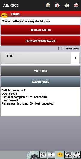

Yes, i believe there is an intermittent short. Doesn't need anything plugged in for it to happen. It "may" also be causing the camera interference you are having.
Do you think either of these are normal or could be causing my issue?1343e399e64cc454547ce547b78f5f6e.jpgc22e9b1d364e52e65630f5948bd021a2.jpg
Is it the far left connector in this picture?ef0142a8c910bec6999ab47619545a11.jpg
'16 CCSB 4X4 G56 2500 6.7 SLT, CTT tuning, UAQ, Single Zone ATC
No, I believe its the one to the right (in the middle) and the wire colors should be light green/light blue and light green/tan.
Do you have an additional video input wired in? I ask because maybe that is what creates the short in the factory wiring somehow. I wired in a separate input for cargo can at the radio.

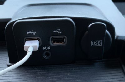

Bit the bullet and ordered a 68283703AA from Benny. Even with shipping and USD / CAD conversion cheaper than my local dealer (just barely).
68283703AA arrived yesterday. Got it installed in the truck right away - pretty simple to retrofit the 2015 center console. I just used a utility knife to trim away the plastic; basically shaved it back carefully until I got a tight fit. Very happy with the fit and, as assumed, works great.
View attachment 249387 View attachment 249388
Sorry for the late replies I'm terrible at that between work and home projects. Yes and no to the additional video input. After figuring out unplugging the harnesses under the seat didn't make any difference I plugged the Customtronix Enzo back in so I can utilize my front camera w/the cargo & backup cams. I plugged in my RCA video splitter into the cargo cam rca on the Customtronix so I can split the feed but haven't taken the time to see if that error code is still there after reverting it back to stock. I just know that with everything back to stock the radio camera screens still have interference with or without the plugs under the driver seat unplugged unfortunately. I've tried pulling the fuse under the hood on the passenger side for the radio multiple times, resetting the radios and checking wiring in the center console, under DS seat and behind radio with no luck unfortunately. Really frustrating because I don't trust a shop to look at it but I'm feeling like I'm at a loss at this point.

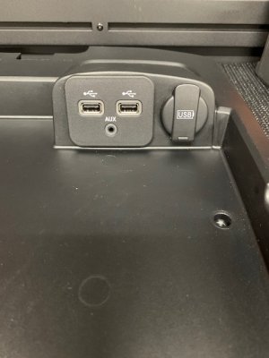

Hoping someone can help with ID'ing a part. I need to order a media hub for my 2014 Ram 1500. I currently have a full center console, and the hub has 2 USB ports and 1 SD card slot.
I don't have to have this same combo of ports on the new hub- I'd just like it to work with a 2018 UAS/UAQ radio and Apple Carplay. I plan to order a media hub harness from @Mpgrimm2
I saw the info around port # 5, but was confused by all of the choices, and non-Ram options.
Can someone let me know which part # will work with Apple Carplay? Thanks in advance.

For your 14ram I'd go with the Chrysler 200 hub
PN: 68328704AC (RAM)
> completely different shape vs 13-17 trucks; exact fit for 18+ JumpSeat with new 2018+ plastic tray insert <
or 5XG28DX9AC (Compass)
> fits with 1/4" gap; 1 USB port only <
or 68283703AA (Chrysler 200)
> must enlarge opening slightly; no gaps <

Thanks @Mpgrimm2 - I'll go with the 68283703AA (Chrysler 200) one. Do you want to update the email info I sent you for the wiring harness with this part #?
And to confirm- this will work with Apple Carplay?
