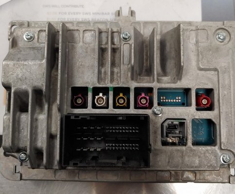

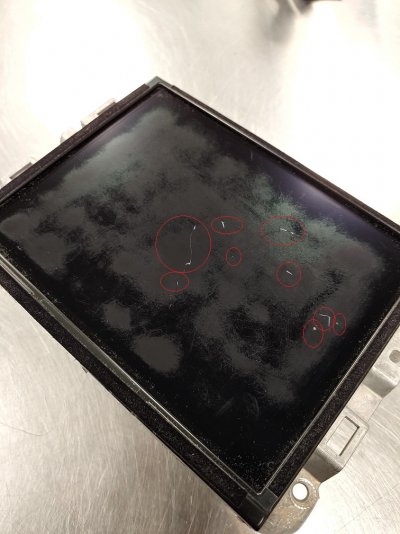

I managed to purchase a 68461704AC (no-nav) today out of a 2020 ram. should be here in a few days. I think my best bet for the media hub is to buy an entire console out of a 2018 compass. one thing I did realize tonight is that the truck it came out of didn't have dual zone climate control or heated seats. can't wait to test it. Mpgrimm2, I'll be in touch for the harness after I locate a hub and do some more reading lol
EDIT: radio arrived overnight. some scratches on the screen and oily finger wear. I'll have to look into how to clean (polish them out). seller offered $50 refund. I'll make sure it works first. lol
