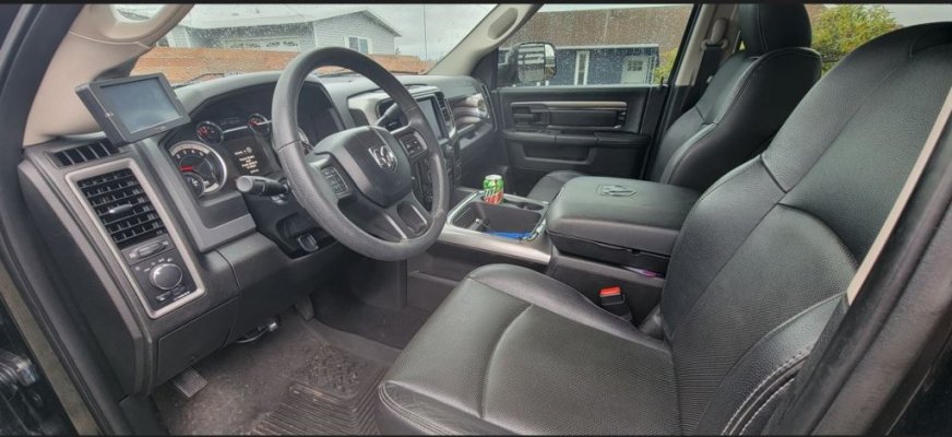

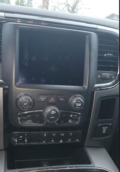

First of all, a big thank you to @Mpgrimm2
I couldn't up done this without his help, harnesses, phone call, and emails.
I have a 2018 2500 Tradesman, 6.7L
I love the power for pulling our trailer (8k 32ft) but it is boring inside compared to our nice loaded 4Runner...
With Mike's help and harnesses I was able to install -
A new (eBay find) Ram 8.4 1500 68331631AM Radio
ATC Bezel (from the below 2017, 1500 donor), 7 Spd fan mod, and Single zone ATC mod.
I did have Mike add the dual-zone option as that will be done when it's nicer out.
I opted to use the dual zone bezel as that's what I'll end up with eventually.
At the same time, I swapped out the front and rear seats (and jump seat) for a complete set from a 2017 1500 sport, leather heated/cooled etc.
Also, the center console, which I used Mike's harness and a USB hub from a compass.
I attempted to take my 2018 jumpseat harness and swap it into the 2017 center console, but that was a no-go.
The 2017 center console harness (assuming center consoles in general) had a junction in the rear so I couldn't use my 2018 jumpseat harness with my 2017 console.
Mike's conversion harness was the answer.
It's so nice having comfy seats, AUTO HVAC, and Android Auto.

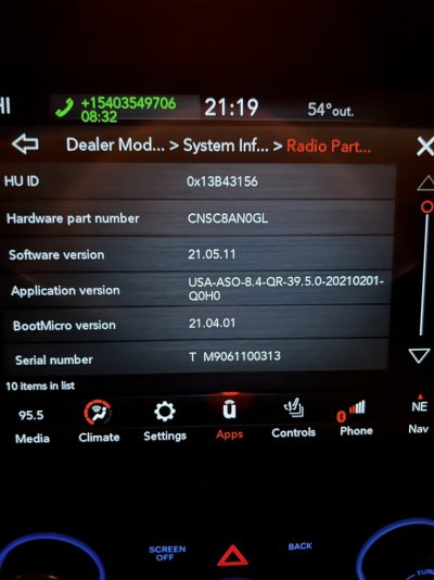

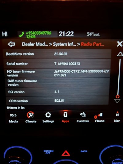

How do I do the update on an upgraded (newer head unit) I have the unlock code but not the vin number it’s registered to?
Thanks in advance for your time and assistance.

Jayson,the latest update is 39.6 you're on 39.5.if you aren't having any issues I would leave it.no vin needed for update but there is always a risk when updating.bricking not to common but can happen.but mostly loss of some apps.39.5 seems to be a pretty decent application.

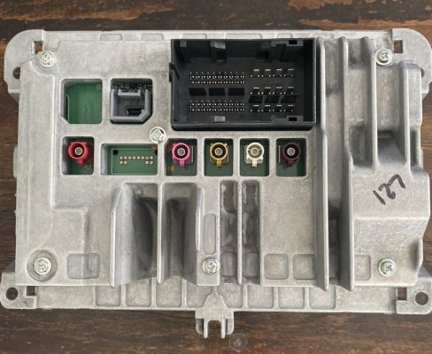

The media hubs in pre 2018 RAMs will not work with the 2018 Radios. Unfortunately RAM changed the form factor of the media hub in the 2018 RAM Trucks. The 2018 hubs are oblong in shape compared to the square 2013 - 2017 hubs. The closest compatible hub that will fit the existing opening is the compass hub. It is not an exact fit, but it generally fits. Changing the hub in a center console truck is easier than changing it in a jumpseat equipped truck.
2018 RAM HUB
The connector on the rear of the media hub is also different, so a conversion harness will need to be built to adapt the current 6 pin connector to the 8 pin on the new hubs.
