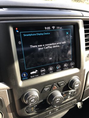

5FE8959E-085B-461F-90BA-69CB294254BC.jpeg One last post before I stop pestering you all this morning...sorry for the flurry in posting.
Turned back on my BT and a few seconds later I get a message on my screen:

That hub looks identical to the one that that only worked with the android. The one that does work for me has different symbols on the front and it also has a 3rd usb connection for another plug in the rear. The one that didn't work with carplay only has one.
That was the same error that I was getting as well

I can connect Bluetooth just fine. I cannot connect my iPhone via USB, though - the radio doesn’t see it. Strange thing...my wife’s iPod connects automatically via USB and starts playing music. But maybe that’s because
It’s a glorified MP3 player? But neither my iPhone nor my son’s iPhone connects via USB. It charges just fine, just not connection to to radio.

Is the consensus here to replace my hub? I worry that it’s going to be the same problem. In other words, why would a new USB hub work? And why should I have to buy one when this one is supposed to? :)
Right now:
  • USB with music is recognized in the media port and plays
  • iPod is recognized in the media port and plays
  • Android phone is recognized in the media port and starts Android Auto automatically
  • iPhone charges but is not recognized as a USB device
If all this is true, then it sounds like either UConnect that needs an update or my phone needs one (and both are allegedly up to date) to fix this issue. That’s where the worry comes in - if I get a new hub, will I still have the same problem?

I say reflash first. Not all drivers are loaded for all configurations.

Seriously, flashing is free and no one has tried it. You can also do it NOW!
It would explain why that hub works for some and not others.

Well shoot! I heard that 19.9 was a good one to have, and I certainly don't want to lose it if it's hard to get. That's a great idea, honestly, SitKneelBend...if someone has the 19.9 update they'd be willing to send my way first. :)
Another interesting note: I plugged my phone in and then turned on the truck. The radio recognizes my phone, as a generic device (it appears) and will play music through it. However, there's no controls on the radio that will work. I can pause, skip, etc. songs on my iPhone, but the controls on the radio will not control it. Weird.

Sounds like it works like the older AUX connection. What does the other USB port do?

Is the “auto show” box checked in your display settings on the radio?

Yes, sir. It is checked.
And yeah, Mike, I certainly don't want to have a dealer start cutting out stuff from my vehicle!
So, unless there's something else that can be done/tried, it looks like the next step is to get one of these hubs.
