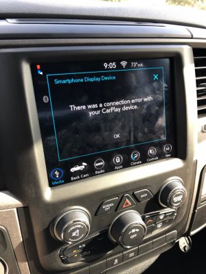

So, unless there's something else that can be done/tried, it looks like the next step is to get one of these hubs.

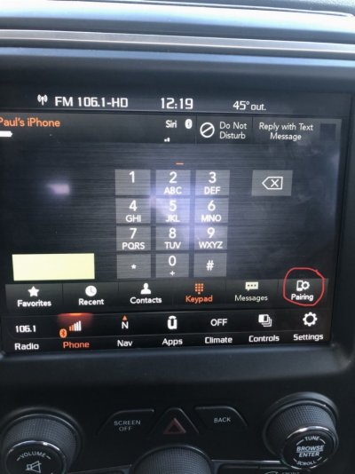

Try this. It’s a shot in the dark make sure your phone is connected by bluetooth

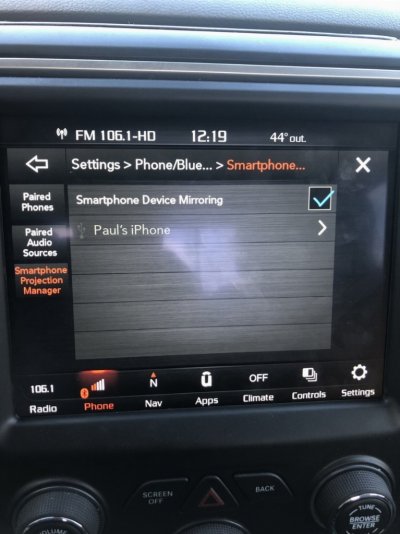

33054e8f16f58a4617737fbb8400b76c.jpgmake sure this is checked smartphone device mirroring

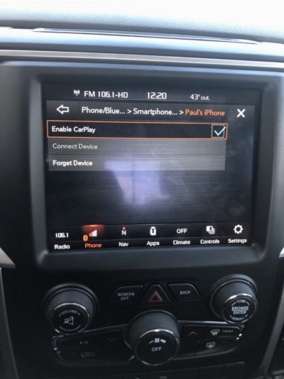

6e078b7b803ae323b9a855ff579fa6b7.jpgclick on your phone and make sure enable CarPlay is checked
Then plug in your phone by the USB port. If one of mine are not checked it doesn’t go into CarPlay automatically

Yes sir, both of those are checked. When I click the "Connect Device" button below, there's a few second delay then I get this:
Now that we have gone through all that I would suggest getting the new hub. PN 68328704
At worst of it doesn’t work just return the radio and look for another one.
