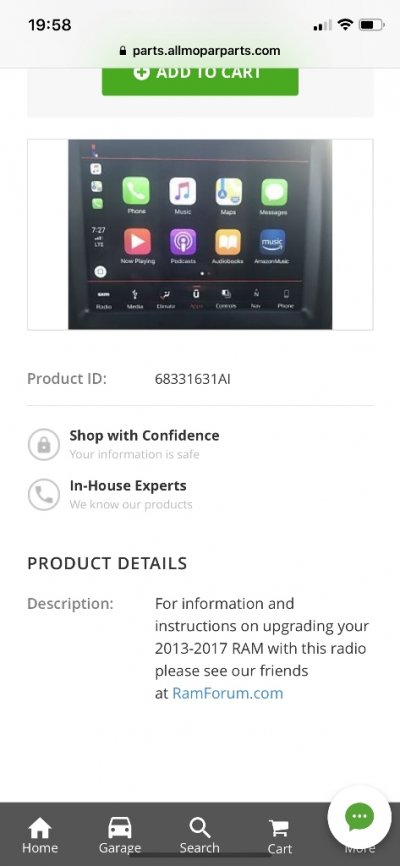

Does anyone know the part number for the two Canadian radios? I can get my hands on a P/N 68340153AI for a decent price, just not sure if it will work.
Also I have a 2017 2500 w/ the 8.4 and Auto-Dual Climate, so it should be plug and play, correct? Just need to switch the media hub?
I believe 2018 UAx Canadian ram radios should start with 6833xxxx. If that 6834xxxx says 'DT' anywhere on it then it's a 5th gen Delphi radio and a no go.
See ...
https://www.ramforum.com/index.php?posts/1125843

No, it's supposedly out of a 2018 Ram and there's no DT markings on it from what I see in the pictures. But I did send a PM to Allmoparparts to double check for me.
Thanks
It does come back to a 2018 model year Ram. Maybe it’s a late model year radio.
