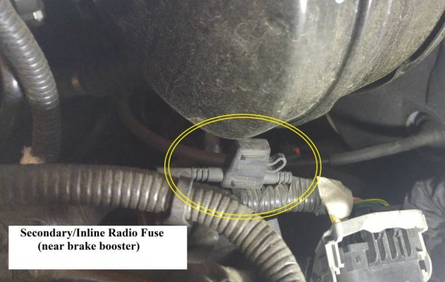

Does anyone have a good clear picture of the "hidden" fuse near the brake booster on the 1500 ? I am trying to help a fellow RAM owner and he says he can't find the fuse. I sent him a picture from a 2500 but he says he still can't find the fuse.
From my previous 13ram1500 ... Same on my 18 Laramie 1500a32c0d76b91e53081ff8d1d99d87f8fc.jpg

Thanks Mike! Sent the photo and the guy found the blown fuse. All is good now with his truck.
