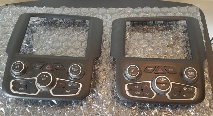

So im hoping you guys can clarify some stuff for me im doing a upgrade to the 2018 8.4 uaq from a 2016 8.4 uas i know i need the Media hub im going to go with the Jeep compass one unless you recommend something different i also purchased the adapter cable is there anything else i need i purchased the uaq off eBay and it is coming with the unlock code i noticed on your thread that you mentioned that sometimes the cargo cam and backup cam do not work is there a work around for this and also i read that sometimes the heater does not move the mixer door all the way to hot are these still concerns or have they be resolved with a work around my truck has the cargo cam and backup camera also has the heated seats and steering wheel which i need to work on the radio because i don't have hard buttons bellow the radio to turn them on
Post a picture of your radio /HVAC dash controls. (Does it have the 'auto' button)?
It will look like one of these...
(Left) Single Zone MTC / Dual Zone ATC (right)
M² Mods.

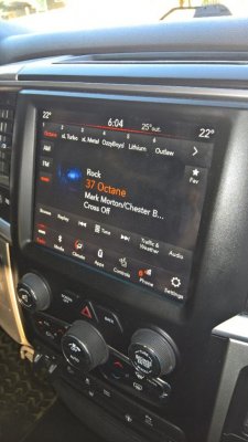

Wow your presets look almost the same as mine except I have Ozzy's Boneyard in slot 1.
