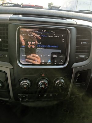

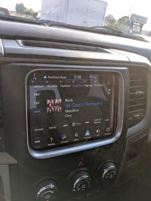

IMG_20190729_173728.jpg IMG_20190729_173759.jpg For those trying to do it a bit cheaper - took a few tries (#@@$#$ LKQonline) but swapped RA2 radio for a 2018 UAS successfully, without changing bezel. Annoys wife she can't reach volume control, but I don't mind :)
I actually have bought the wrong model twice, but another forum member & I connected and we swapped units, which worked out great for both of us (I had a 2019 UAS that I couldn't use, and he had a 2018 UAS he couldn't use - so we swapped and worked out great). (my old RA2 & that incorrect model RA4 are on ebay....)
UAS radio (~ 475 with warranty from LKQ), harness from M2Mods ($40), Hub from ebay ($98) - all in about 650. I didn't want to mess with AC controls, etc - very happy with how it turned out. Only thing you notice is that the fan indicator on the screen only goes up to 4, vs 7 speeds, which I am learning to ignore. Wasn't worth the additional aggravation.
Love android auto, makes my truck feel newish again, without that new car payment. Good for another 60,000 miles or whatever shiny new toy comes next, LOL!
Will upload picture later, but the 2018 screen is just slightly wider, so you don't even notice the gap from the earlier radios.

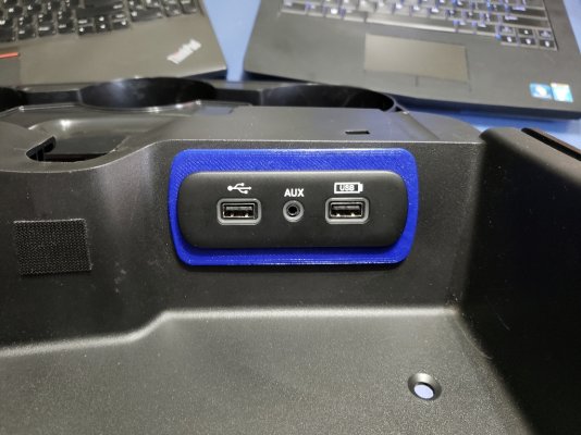

The design is done and test fits in a spare console top have been done, but we need a test fit in a truck to insure that there is no interference between the hub and the bracket inside the console/seat. Unfortunately, I'm having trouble getting it (or anything else) to print in the Tough PLA plastic. The regular PLA is not strong enough, the tabs that hold the adaptor into the console break too easily. Once everything is confirmed as fitting then we can can set them up for printing in Nylon plastic from one of the commercial services and not have to worry about the material strength, but first I need to get a successful print in the Tough PLA for the final fitment testing. I've got another attempt running right now, a single adapter takes about 2.5 hours to print on my little printer.
This is one done in Blue PLA for contrast in photographing. The final design will have nicely rounded edges and therefor look more OEM but this shows that it fits in the console opening and that the hub fits in it. The final design is also a bit shorter (doesn't come as close to the top edge).
