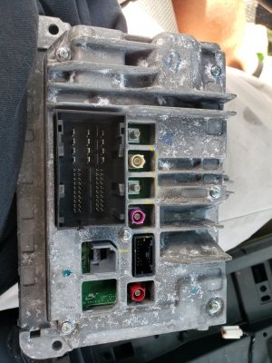

Sooooo..... I was in a hurry and bought a radio from a 2018 Ram Limited 2500. I didn't notice that it was actually a Candian market truck. The radio is a 68331632AH vs the 1635AH part. What will it have or not have compared to the others (correct ones) that I have used?
If this won't work in the US- Does anyone in Canada want a good deal on one with 0 miles on it?

Several people were successful using the Canadian 13-17 RAx radios in they're trucks before... It should work if it's out of a Canadian ram truck. Just won't have the 4g cellular modem in it and uConnect services you can't use anyway. Let us know how it goes Iif you get it

So is there somewhere that lists which color coax plugs are what? I know that some won't end up being used. This unit has a few coax plugs without the actual plastic on them to lock it together. 20190901_120219.jpg

Yes. I believe my 13-18 8.4 FW info and
PN thread or 8.4 conversion thread has a picture and pigtail Adapter links for the connecting to the plugs with missing colored clips
Edit: found it...
https://www.ramforum.com/index.php?posts/1937443

Good lord, what happened to the back of that radio? I have never seen corrosion like that on a radio.

Agreed. Probably sat a salvage yard truck with a broken windshield for awhile. If the outside looks like that, I wonder what the control board inside is like. Hope it works for him and he got a good deal.
@PJs97Talon I edited the previous post with the link you needed.

It's actually just been sitting in my basement for a while. Normally I have a dehumidifier running but haven't this year. It looked better when I brought it home.
