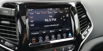

Hello,
My car is a Jeep Cherokee KL 2015 and I write here because I made upgrade of my Uconnect. I read a lot of about this before but I couldn't find any information about my problem:
Original version is 8.4" iwth Nav. Now I have Uconnect 4c 8.4 with NAV. PN: 68396161AC with software IR 22.5 (18.33.24). Everthing is fine except radio FM - I have very low signal. I can find only 1-2 stations (my old radio could fine 8-10 in the same place). I checked connection of antennta and it's ok. Do you have any ide why radio reception is very poor? I have shark antenna.
Thank you in advance!

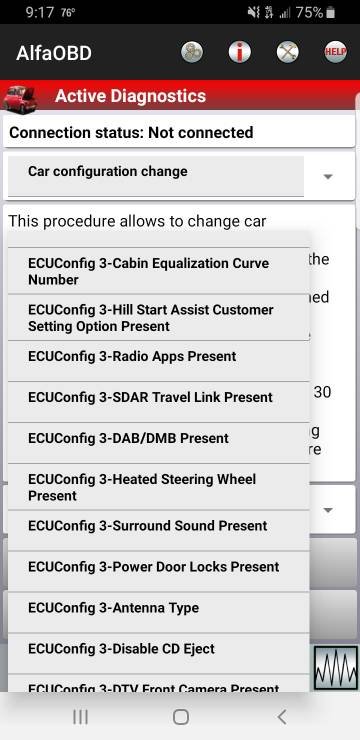

Anyone have any idea about this issue? I have a 2018 Express that came from the factory with a no bluetooth radio. I installed a UAQ almost year ago, a @Mpgrimm2 microphone harness, a 2016 microphone mirror and everything else I needed for ATC. Here's the issue everything as far as nav and everything else the radio works perfect except when I make a phone call. If I make a call the only speaker that gives me the called person's voice is the right door (rcsb)and it's faint. If I'm receiving a call it's crystal clear, loud and coming out of the dash. I noticed it before but really notice it now because I'm traveling cross country with the truck loaded and I stuck a suitcase in the passenger footwell and it's blocking the speaker somewhat and I'm making a lot of calls.

Check your Ecu Config 3 - Cabin Equalization Curve setting with AlfaOBD.
Is your truck a standard 6 speaker RegCab or Alpine RegCab?
May need to compare with someone else's RC truck AlfaOBD settings file.

@Mpgrimm2 I will check that. Right now the bypass and Mx+ are in Albany NY and I'm in Shamrock Tx en route to NY for the final trip. It's a standard 6 speaker truck but when sorting it out on the initial install , the OEM bcm log had it set as an Alpine so after discussing it with you and @Lawsuit11 , I changed it to standard cab 6 speaker base DS. I just verified that by looking at my Google drive BCM dump from March, which was the last time I did anything.
Anyone have a Uax radio in a rcsb that's willing to share their cabin EQ setting information?
I'll be home by Sunday night unless I have trouble at the intersection of I90 and 79 in Erie Pa. The last 3 times I went by there the truck kept trying to turn down 79 towards Pittsburgh cuz some harness maker there keeps saying come on down. Lol

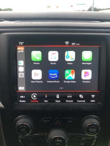

Hey lawsuit, did they fix music apps like Amazon Music showing up with a blank screen? Every music app except Apple Music would give a black screen after a few days of in the car out of the car. Multiple threads about it across multiple vehicle brands. I have a UAQ, iphone 6s+ and iOS 12.4.
Lawsuit11
Sep 10, 2018
819
685
Westland, MI
2018 1500
I’ll keep you updated. I just got the IPhone Pro max yesterday and I use Pandora when I get in the truck to see what happens for the next few days. It’s been perfectly fine yesterday and today so far. I usually run amazon music and Apple Music

Solved this issue somewhat. Turns out when making a call while I'm listening to Sirius XM and using Android Auto for navigation only the right dash speaker has the other persons voice. Any other way using, regular BT or Android auto w/Spotify or even the UAQ nav there is no issue and the left speaker works perfect. So I actually don't care and now consider it a programming issue cuz the radio sounds great.
