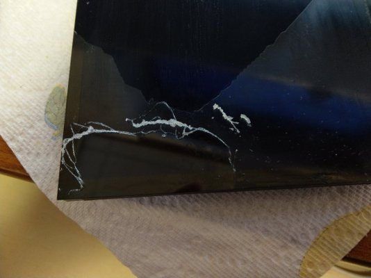

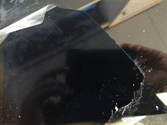

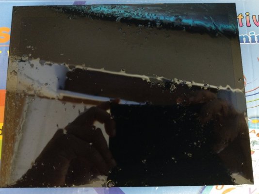

Going nuclear on the screen. I've discovered that what may seem like a really scuffed screen is actually a really scuffed factory anti glare laminate.
It is removable with heat, WD-40, Isopropyl Alcohol and patience. It also leaves you with a pristine screen you can apply a new screen protector to. Do not apply too much heat but the heat is necessary to pull the liner up. First the protector comes off and leaves adhesive. The adhesive gets soaked in WD-40 to soften it up. The alcohol gets the adhesive and WD-40 up. The final cleaning was performed with electronics cleaner.
I'm hoping it cured my phantom touch issue as well. The factory liner was peeling up at the corners I believe from the aforementioned oily substance that may have coated it in the accident.

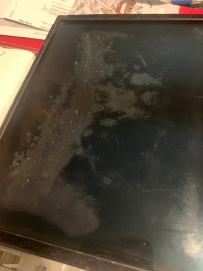

Think that will fix this one?
Yes. So long as the screen isn't cracked. It took me about 3 hours. I used a heat gun at 400-500 degrees to get it warmed up enough and my finger nails to get enough protector up to begin pulling towards me.
If you go slow and heat up when necessary you could get the whole thing off in one go (I unfortunately didn't). This is one of those things where the slower you go the faster you'll get done.
I should also mention to let things cool before applying any cleaners to it. Especially the alcohol as it will evaporate quickly and therefore cool the surface rapidly.

Did you remove the screen from the rest of the radio before doing this?
Yes, it must be removed but it was fairly easy. This video got me started...

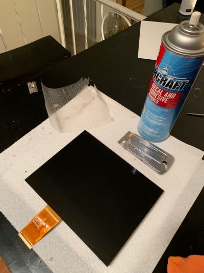

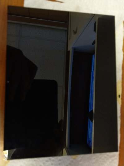

@SitKneelBend was right. I was able to pull up the laminate and there was a perfect screen behind it. A few things I did different were I actually used a hair dryer for heat because the heat gun I had was only 750° or 1000° and I thought that would be too much. Once I got a corner up I started using a razor blade which made life much easier. Once the screen protector was up I used a decal and adhesive remover and micro fiber cloth. After a few rounds with that I had all of the adhesive off and a brand new screen! The picture has all of the things I used in it.
Great work! I thought about a razor blade too but I wasn't sure how the glass would hold up. Luckily my fingernails held up throughout the process!
Edit:. Look at the patience on Joe! He pulled it off in nearly one piece!

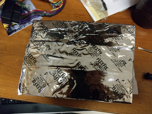

So, I think the issue with the ghost touches on screen may actually be the radio overheating and the touchscreen being affected by the excess heat. This would explain why letting it sit for a bit clears the issue up but it always returns.
That being said, has anyone else felt these radios run hot? I know it's all passive cooling but mine seems to be hotter than it should be.

Just threw my RA4 in to compare. The UAS is glacially cool by comparison. The RA4 is literally too hot to handle even 10 minutes after being in the truck but the screen remains cool/warm to the touch.
Now I'm wondering if I can somehow insulate the screen from heat better? Anyone know of any heat reflecting materials I could put between the screen and the radio to test? Anyone ever open an RA3/RA4 and see how they manage heat?

I fashioned a heat shield of sorts which consists of fiberglass motorcycle exhaust wrap covered in foil tape. I plan to put it between the screen and the rest of the radio to see if I can keep the screen cooler.
