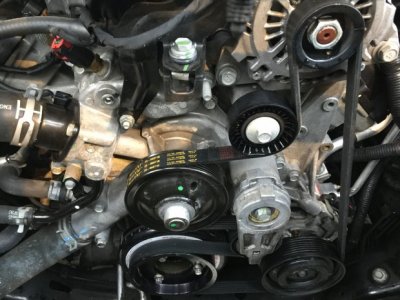

Pulley shot with ATI Super Dampener pulley 70.5" NAPA Gates belt

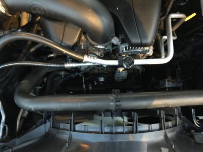

Picks of 2 fans.
