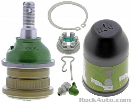

This Mevotech TXMS25563 upper ball joint is listed as "Premium" with Rockauto and is greasable. I haven't tried them ...but you might take a chance on it ..and keep them greased..

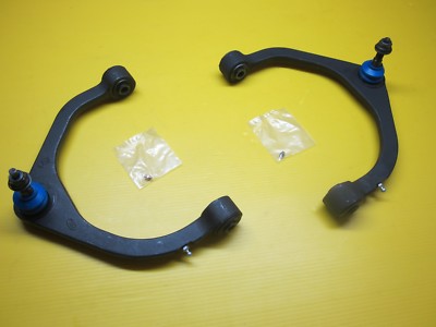

There are also forged steel upper a-arms which should be stronger than stamped steel or aluminum. It looks like a good product and I would think (hope) they sourced a quality ball joint as well (it's greasable). Has anyone used these?
OP has a 2500, not a 1500. Different setup
