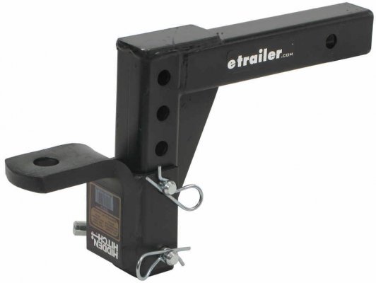

The "do it all drop" ball for your truck would vary depending on the height of the trailer relative to your truck. I have an adjustable unit I got from etrailer that allows me to raise or lower the height of the ball relative to the trailer's height.
If you don't have a hitch on the truck now then I'd suggest a Class IV for the additional tongue weight up to 1000 pounds.

How much did that hitch run you?
crash_eco
Sep 20, 2015
443
128
Canada
hemi
the one i have is a reese one, similar to that. it cost me about $60 cdn.
MADDOG
Living in a Firepit
Dec 26, 2011
15,200
11,502
Arizona
6.4L HEMI
It's listed at $60 USD + shipping.
