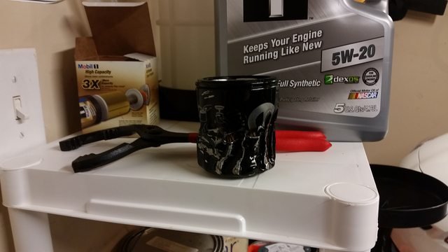

Tried to do an oil change on my new 2014 1500, after a bit of a break in. Drain plug was simple enough, but the damn oil filter will not budge. It's literally breaking under the force of the filter wrench. Srew driver in filter time or what guys? The incredible hulk should stick to breaking ****, not installing filters :p.

Try a rubber strap wrench.
I can give that a shot. It's not that my current wrench is slipping, it's just that the filter is breaking under the force :(.

It'll distribute the torque better than your typical filter wrench.

Yea you know what, after I posted that I was thinking the same thing, you're probably right, i think this thing is pinching it.

Since it says "FACTORY INSTALLED" on the filter I'm assuming this is its first oil change. They're always rediculously tight from the factory.

yep you need something wider. you have to remember these things will tighten up on their own after a bit(just like jars) so you can't fully blame the factory/mechanic but really they should never be installed more then hand tight plus a little extra

also try to get the wrench up as high as possible near the very top of the filter

The factory installed ones are always super tight. They have those robots cranked up way to high.

Thanks fellas, was able to get the ****** off finally. It was indeed the factory installed one, said so on the bottom. I just wanted to swap out to synthetic now that I've driven it for a week.
Tried the screw driver method, no go, I could see it start to rip the filter. It's just too flimsy for that method.
Ended up taking my G8 out to a parts store and bought a socket deal and a wrench as a backup. I was thinking the socket would fit the mopar filter since it fit my mobile 1 replacement filter, it didn't. I was happy I bought the new wrench, I just gripped the crap out of the filter with it and yanked it 'till it turned. Still was way too much effort.
