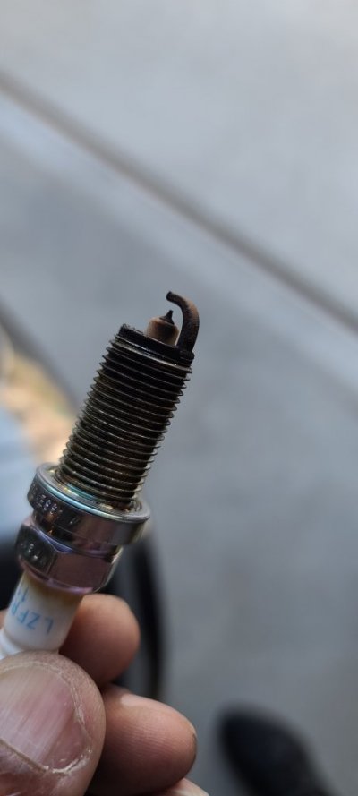

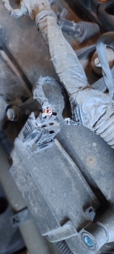

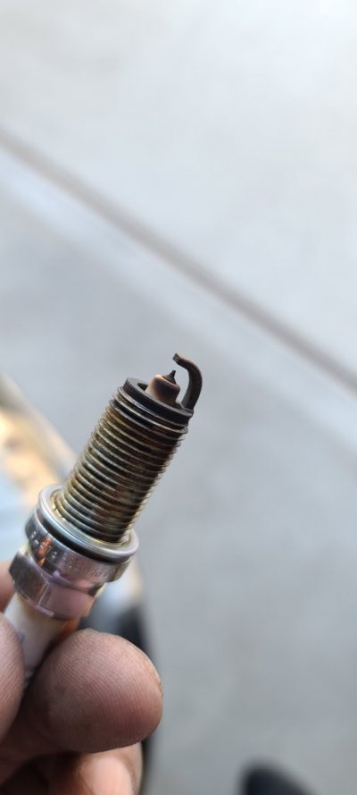

Same with my coil at cylinder 2 pulled a P203 and P0302 code. Replaced the coil, spark plugs, and the pigtail wires... still get the codes. Took it to the dealer and they've had to for over a week now. I'm thinking it's the pins connecting to the pcm. Any luck on finding the cause?
