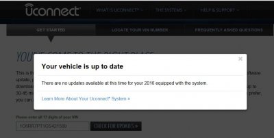

the site give me this error
Error with VIN number
Sorry, an error has occurred. Please ensure that the VIN number you entered is accurate and that you are using a supported browser then try again. For a list of supported browsers, please visit FAQ - Frequently Asked Questions about Uconnect® Access.
Post your VIN so 00R/T and myself can check also.

my vin: 1C6RR7PT1GS421589
navrepair reply:
It states there are no updates for your vehicle.
There probably isn’t a version 16.xx.xx for the EU quite yet.
the ram in europe is not officially imported, so I think we will never see official updates of our navigator
the only solutions that i think is install the US firmware or if is not compatible build a custom firmware for our EU uconnect
navrepair reply:
Yep, I show the same thing... No Updates Available. I wouldn't recommend you load one of these RA4/VP4-NA updates on your EU unit. CustomTronix may be your only option.

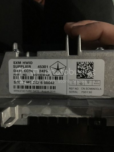

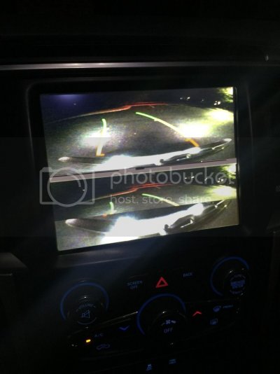

I had a 2017 RA4. It worked perfect and was amazing, great gps, but the backup camera didn't work, it was distorted and split into 2 images. Couldn't live without my backup cam. PN was 68283240AB.
Do you know what sw version was on it at the time?
What year truck was it installed in? (is 2013 correct per your profile?)
Where there any other noticeable differences b/w it and earlier RA4's?
Do you happen to know if GetupK is still making conversion harnesses? I'm seeing lots of requests.
PS: I know on the 2016 RA4's that cargo cam and 3rd video inputs are swapped from what customtronix uses with their sw jailbreak.
TNram
Jan 12, 2016
139
21
Nashville

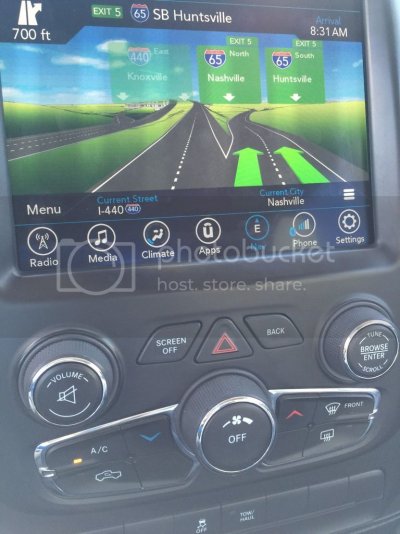

It was obviously out of a Chrysler since I couldn't get the logo off the boot screen. I had it installed in a 2013 and also tried it in getupkid's 2013 and had the same issues. Major difference in previous models. Completely different display. Map could 2 finger zoom. It is customizable similar to the 2016.
