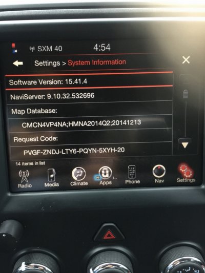

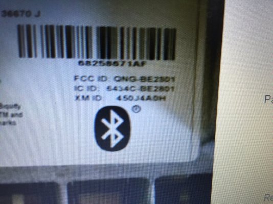

ehart814
Aug 9, 2016
71
28
Ecodiesel
Does this help anyone?
68258671AF - 2016 I think...
Software: 15.41.4
Installed and working in a 2016 Tradesman (other than Siri will not work). I do not have access to the vin of the donor vehicle.
I would like to update the software if it's a good idea. Keep seeing mixed reviews though.

With a 2016 RA4, It's s good idea to use the dealer menu (see bottom of OP) to verify the radio pn and sw version match what you posted AND especially match the pn physically on the back of the radio before you attempt to flash anything (may need to pop the radio out briefly).
There have been a few cases where it doesn't match and makes choosing the correct sw a PiTa. But it did look like you have an available update.
From my Up All Night Sleep All Day Gs7 on Tapatalk
The part number I posted is verified - I took a pic of the back of the radio. When I said "i think" what i meant was I think its a 2016 radio.
Thanks for the info. I would like to do update it if the update will make the Siri hands free work - currently Siri doesn't hear what I say.
Do me a favor and post that picture of the back and a picture of the Dealer Menu screen showing what pn and sw version are currently being reported by the radio to make sure they match.
You could always just try the latest sw version for your 2016 RA4 linked from the OP (v16.09.09), but it would be wise to verify the above first.

I don't think I can get my unit to dealer mode because I am using the oemautoparts.com bezel so I don't have the buttons.
No you can't access dealer mode without the factory bezel (or reset the radio), so here's the deal...
Your radio pn label indicates it's a 2016 Ra4/vp4-na and your fw shows 15.41.4 (vs the 15.44.4 I pulled previously off the Ram uConnect update site w/valid vin, maybe I have a typo).
You can certainly update to the latest 16.09.09 fw but there is obviously no guarantee you will be able to roll back to 15.41.4 later.
See post 5 for 2016 fw and make sure you verify the md5 of the downloaded file to make sure you don't get a bad D/L.

I'd really like to get the siri eyes free working... Is there any reason I should be hesitant to update to the 16.09.09 FW on this radio, in my 2016 truck?
Also, does the 15.41.4 version also verify that the radio is my2016? Has anyone bricked their 2016 radio updating to the 16.09.09 in a 2016 truck???
Did your truck come with an 8.4 from the factory? If so, go for it. If not, you can still attempt the flash but it is very important you download the correct firmware package from UConnect.
