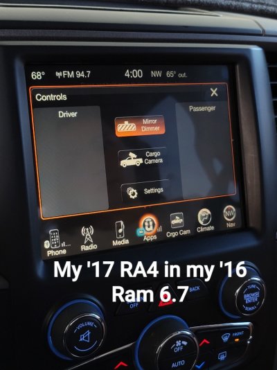

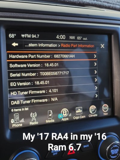

I will try the radio reset today then BCM camera settings if reset will not remedy. Here are the two pictures of my radio currently. Looks like I'm running the newest software and the corresponding part number matching the sticker on the back of the radio itself. [emoji848] What BCM camera settings do you recommend me toggling? Radio trailer hitch camera?f611b844d7c871e8ccf1f0a919f39f78.jpgf98996947666d9b0b3987ee114d10ca8.jpg

I may be missing it but I went back to the first post on this thread & searched for resetting and have not seen or maybe I have overlooked where it was mentioned. I believe I select "Reset Radio" but wasn't sure what the difference was between that and the "Reset to factory default" option.
UPDATE: Attempted reset radio first, then reset to factory default with no luck. After that I turned off radio trailer hitch camera then disconnected and shut truck off and let it sleep for a minute fired it back up turned it back on and no change. Finally turned off backup camera and back on and still no change.

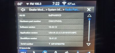

2018 Ram 2500 Limited, (UAQ 4C Nav) where is the radio part number?
My 2018 (UAS 4c w/o Nav) just updated with the same version. Everything seems ok but I haven’t checked all of the functions yet.
Mopar Radio PN is on a sticker on the side of the radio (likely correlates to the Panasonic Hardware PN on the info screen)....

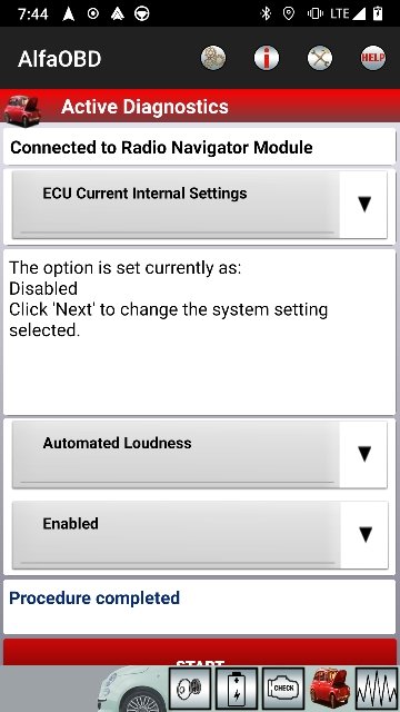

Found this setting that works (2018 UAQ). It didn't cure the notification volume reverting to 15 every time but it did turn off the loudness "effect"...
Has anyone successfully cured the loud notifications on these?
I've tried to do this on my ram but can't find this option. What year are u accessing to do this?
Sent from my SM-G981W using Tapatalk
See above post by SKB
