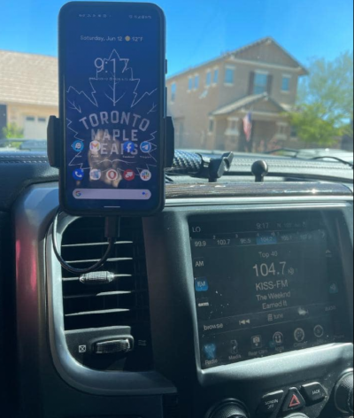

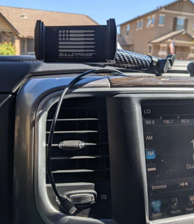

I believe I've researched enough and wanted to confirm that I am on the right track. I am about to pull the trigger on a UAS 68331635AK pulled from a 2019 1500 Warlock and going to install in my 2016 1500 Longhorn/Limited.
What's the difference between 68331635AA & 68340153AK ?
After Install, will the radio have all the features enabled for my Ram? Heated/Cooled seats, back up camera, 7 speed fan, etc etc.
I have hardwired a charging cable just above the radio so I can have my phone charge while in the phone mount. Is there a secondary connection from the new media HUB that can be run from the Media hub to where I want to run for charging and for Android Auto?
MEDIA HUB: 68328704AC (RAM)
MEDIA HUB CONVERSION HARNESS
Also looking for members recommendations for where to buy the HUB and Harness. I also believe I saw where someone can 3D print a bracket to fit the media hub?
