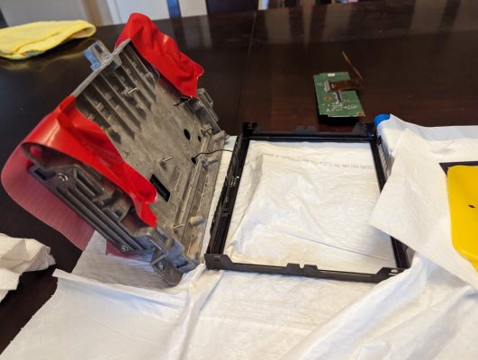

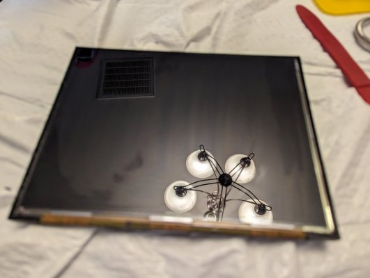

Picked it up, ordered a replacement digitizer (not the entire LCD screen) and will spread a few hours cleaning up the glue.
Testong things out, on the back of the VP4 I have the maroon, mustard and white cables connected, on the UAQ, the mustard and white connect fine but the maroon will not connect because of the notches are in a different location.
What is the maroon cable for?
Does it need to be connected?
Can I just add a notch in the plastic to fit?
on the UAQ, looks like a couple piece missing, is this okay or can they be fixed?
I would like to reposition the USB hub behind the radio and have a cable come through the top so I can connect the phone there as opposed to running a cable across the center console.
What's left to get here... USB hub from 2018+ and a conversion harness?

Great price! Don't be surprised if you end up replacing the whole screen though. You can get away with just the white plug (AM/FM) and mustard plug (SXM/GPS). In order to use Android Auto/Apple carplay you will need the newer USB hub. IMO you should just mount it in the factory location because no matter what you will need an adapter harness to connect it. @Mpgrimm2 can sell you the harness and let you know the part numbers you need to complete the upgrade.

Just the ghosting issues where channels would change, AC and temps changes, all the delaminating issues I've read about. Hopefully I can clean the LCD enough and with a new digitizer ($20) even if it doesn't work, a new LCD and I'm still under the cost
While testing, I was able test everything but radio as I didn't have the anti theft code until today. Back up camera, ac in the seats, 7 spread fan.
As for location of the hub, appreciate the feedback, pretty much set on running the cable through the dash like I already have for power (as seen in 4th image, but that's a me issue, not you)
So do we know what the maroon cable is?

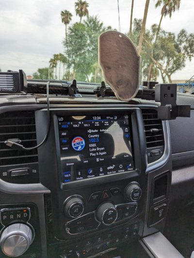

Took me about an hour to clean all that glue and install new digitizer. Installed in truck and everything is working... steering wheel controls, heated and ventilated seats, radio, air ride suspension.
Ordered hub and harness, will post updates on Android Auto and Carplay.

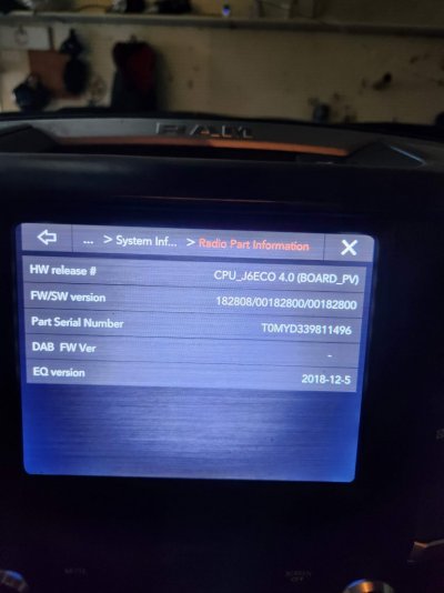

So I've search most of this tread and not seeing anything that is matching my radio I have a 2019 Ram 5th gen 8.4 nonNav radio below are from the dealer screens.. I've been looking for updates for this radio..not sure what the firm version

Nothing in this thread applies to a 5th gen truck
