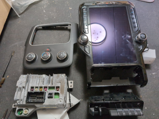

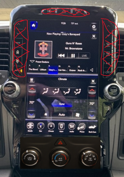

I've been thinking about doing this swap in my 2014 since I got a 3D printer for Christmas. I was wondering about making a custom bezel that sandwiches the screen to the existing 4th gen HVAC bezel and maybe tackling the buttons on the screen sides not working by taking a different approach.
I'm wondering ( for those who have done this) if instead of making the buttons work via a CANBUS module if one could simply fit the HVAC knobs from an RA2 bezel into the lower portion of the 12" screen bezel and use those controls instead? I'd likely try to delete the side buttons entirely and just have blank bezel in their place if this ever worked.
I'd have two buttons I'd need to figure out what to do with (traction control and tow haul) but the are rarely used anyway so not terribly concerned.
Just thinking out loud about this looking to break something while tinkering. Anyone have any thoughts on this approach? IN particular thoughts from @Jimmy07 , @Roman217 , @skuppy069 , @48PowerWagon , @chri5k , @Ramit2016 and @Mpgrimm2
Here are my thoughts (crudely) pictured if it helps understand what I'm getting at. I've also thought of angling the screen slightly more toward the driver since my truck has no auto climate controls for the passenger anyway.

Well wish me luck, got most of the parts in today and a 2016 BCM arriving tomorrow . I may buy a dash center stack bezel to work with so I don't have to constantly remove mine for fitment (I'll be about $800 dollars in total)...
