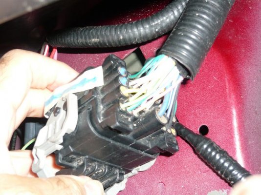

Unfortunately not all Ram's with an electronic locking tailgate have the harness needed for the backup camera. I have a 2017 Ram 2500 with that tailgate in which I installed the OEM camera and it did not have the needed harness for the camera. What Ram's with the electronic locking tailgate will usually have (see more at end of post) is a short jumper harness that goes from the tailgate to under the bed and ends just to the rear of the left rear wheel and should have the 8 wires if you have the electronic locking tailgate. This harness is less than 2 feet long. It connects to another harness that runs forward (the full length of the truck) to a connector that is behind the left front wheel and hidden by the plastic fender liner. This is the harness that you will need the 8 wires in. Mine had the 8 wires only in the short jumper harness, but only 2 wires in the harness running forward. Instead of using the OEM aftermarket kit, I used a custom harness made by M2Mods. It actually makes the installation OEM as if it came from the factory, the kit sold by Ram has differences from the factory OEM setup. More: To make matters even more confusing, there are some model Rams that do NOT have that short jumper cable.
I pasted below a pic of the connector that is behind the left front wheel.
